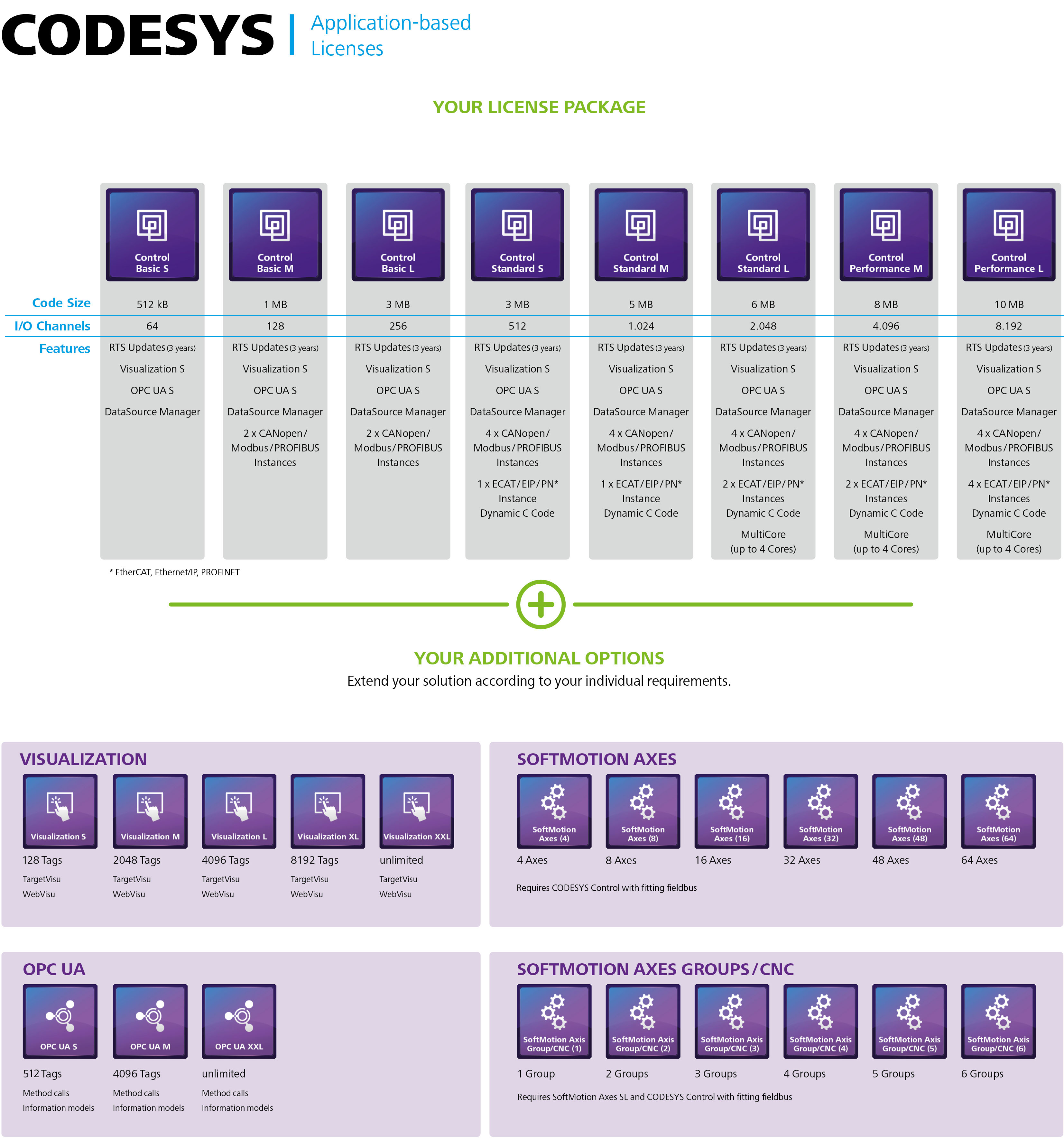

The CODESYS Application-Based Runtime Licenses provide truly hardware-independent licensing to CODESYS customers. Application-Based Licenses are scaling with the scope of the application running on any CODESYS SoftPLC supported platform. The scope of the application is defined by the number of I/O channels, number of fieldbus networks, number of visualized variables, code size and additional options such as SoftMotion. The device view in the CODESYS Development System shows details of the application scope in a CODESYS project for licensing purposes.
At the core of the Application-Based Licenses are eight main license levels to choose from, plus optional add-ons for advanced features. The Application-Based Licenses are starting at a very low price for small applications and grow with the complexity and size of larger projects. Easy upgrades are available as needed to grow with your application.
The result is a very economical and transparent licensing model for most control and HMI applications. Running the same application on a powerful industrial Windows PC or on a low-power Linux edge device is now possible with the same license at the same competitive price.

In the following graphic you will find an overview of all runtime licenses and their additional options:
CODESYS Control Basic S CODESYS Control Basic M CODESYS Control Basic L CODESYS Control Standard S CODESYS Control Standard M CODESYS Control Standard L CODESYS Control Performance M CODESYS Control Performance L CODESYS OPC UA M CODESYS OPC UA XXL CODESYS SoftMotion Axes (4) CODESYS SoftMotion Axes (8) CODESYS SoftMotion Axes (16) CODESYS SoftMotion Axes (32) CODESYS SoftMotion Axes (48) CODESYS SoftMotion Axes (64) CODESYS SoftMotion Axes (96) CODESYS SoftMotion Axes (128) CODESYS SoftMotion Axes (256) CODESYS Visualization M CODESYS Visualization L CODESYS Visualization XL CODESYS Visualization XXL SoftMotion Axis Groups/CNC Interpolators (1) SoftMotion Axis Groups/CNC Interpolators (2) SoftMotion Axis Groups/CNC Interpolators (3) SoftMotion Axis Groups/CNC Interpolators (4) SoftMotion Axis Groups/CNC Interpolators (5) SoftMotion Axis Groups/CNC Interpolators (6)

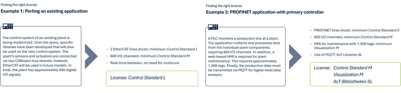

How to find the correct license
The following questions will guide you to the right license for your project:
  • Which fieldbus is required and how many instances?
  • How many I/O channels will be necessary?
  • Do you need high performance and stable real-time behavior?
The corresponding metrics can be found in the device dialog of the CODESYS Development System under the tab “license metrics”.
All available licenses with their parameters can be found here: Application Based Licenses
