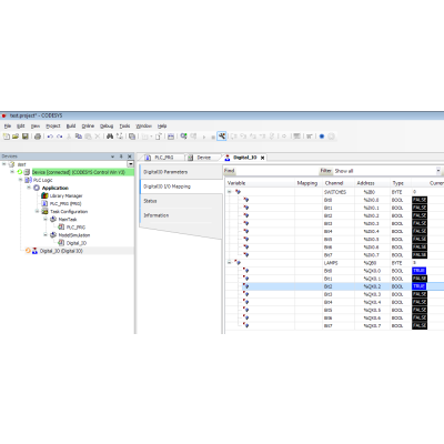

The online training is intended to teach the participants the handling of the CODESYS V3 programming system, the interaction with a CODESYS V3 controller and the general creation of an application according to IEC61131-3. This training is aimed at beginners in the CODESYS world, but is also suitable for those who are changing from CODESYS V2.3.

The training is held by a trainer. The theoretical part is followed by practical exercises to facilitate the transfer of knowledge. By means of use cases it is demonstrated how the tool can be used. The training participant gains knowledge about the following aspects of CODESYS V3:
  • Elementary data types
  • Project management
  • Simple programming logic (FBD/LD)
  • Own data types (DUT)
  • Structured Text (ST)
  • Hardware configuration
  • Program Organization Units (POU)
  • Diagnostics (Breakpoints,Flow Control, Watch, Trace)
  • Signal flow chart (CFC)
  • Sequential function chart (SFC)
  • Simple visualization
  • Visualization with interface
  • Backup and restore
