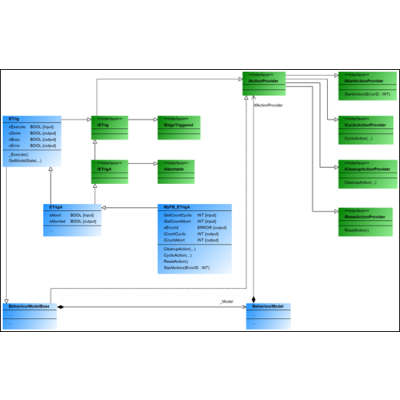

The online training is intended to familiarize the participant with the CODESYS Object Oriented Programming language features according to the IEC61131-3 3rd edition and enable the creation of device-independent libraries with extensive documentation. The training targets device programmers, application developers, and software engineers in the automation industry.

The training is online led by an instructor. Throughout the training, theoretical parts are followed by practical exercises to facilitate knowledge transfer. Use cases are explored to demonstrate how the tool can be applied.
The participant will become familiar with the following features of CODESYS Object Oriented Programming according to the IEC61131-3 3rd Edition:
  • KEYWORDS: Property, Method, Extends, Interface, Implements, Access specifier
  • Pointer: THIS, SUPER
  • QUERYINTERFACE
  • Library: Common Behaviour Model
  • Administration of POUs in list and trees
  • Library development
    • Library types
    • Access control
    • Documentation
  • Package Designer
The participants will learn how to:
  • Benefit from using interfaces and the inheritance of function blocks with OOP.
  • Create FBs with PLCopen compliant behavior.
  • Benefit from being versed in using the Generic fieldbus diagnosis.
  • Improve code quality and avoid code duplication.
  • Improve reusability and maintainability of code using libraries.
  • Create device-independent library landscapes and using library types correctly.
  • Provide descriptive, multilingual documentation in various formats.
  • Distribute of extensive library landscapes including documentation with a CODESYS package.
