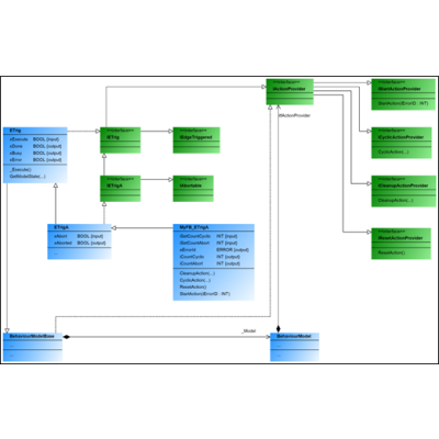

The participant will become familiar with the following features of CODESYS Object Oriented Programming according to the IEC61131-3 3rd Edition:
  • KEYWORDS: Property, Method, Extends, Interface, Implements, Access specifier
  • Pointer: THIS, SUPER
  • QUERYINTERFACE
  • Library: Common Behaviour Model
  • Administration of POUs in list and trees
  • Library development
    • Library types
    • Access control
    • Documentation
  • Package Designer
The participants will learn how to:
  • Benefit from using interfaces and the inheritance of function blocks with OOP.
  • Create FBs with PLCopen compliant behavior.
  • Benefit from being versed in using the Generic fieldbus diagnosis.
  • Improve code quality and avoid code duplication.
  • Improve reusability and maintainability of code using libraries.
  • Create device-independent library landscapes and using library types correctly.
  • Provide descriptive, multilingual documentation in various formats.
  • Distribute of extensive library landscapes including documentation with a CODESYS package.
