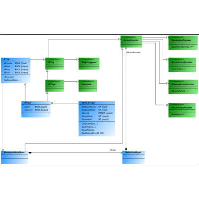

The participant will become familiar with the following features of CODESYS Object Oriented Programming according to the IEC61131-3 3rd Edition:
  • KEYWORDS: Property, Method, Extends, Interface, Implements, Access specifier
  • Pointer: THIS, SUPER
  • QUERYINTERFACE
  • Library: Common Behaviour Model
